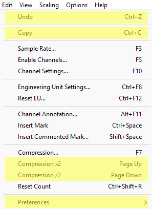

Edit Menu
Additional options: Undo, Copy, Compression x2, Compression /2, Preferences

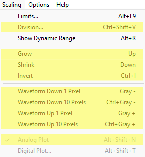

Scaling Menu
Additional options: Division, Grow, Shrink, Invert, Waveform Down 1 Pixel, Waveform Down 10 Pixels, Waveform Up 1 Pixel, Waveform Up 10 Pixels, Analog Plot

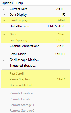

Options Menu
Additional options: Limit Display, Grids, Grid Spacing, Fast Scroll, Pause Graphics, Beep on File Full
