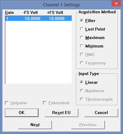

This displays the Channel Settings Dialog Box
Channel Settings for the DI-1110
Choose the desired Acquisition Method for the selected channel.
Average
Default method. This method averages all of the data points in the burst sample and reports this average as the single value for storage and display.
Last Point
This method reports the last input data point in the burst sample for storage and display. The rest of the data points in the burst sample are ignored.
Maximum
This method reports the highest value data point in the burst sample for storage and display. The rest of the data points in the burst sample are ignored.
Minimum
This method reports the lowest value data point in the burst sample for storage and display. The rest of the data points in the burst sample are ignored.
RMS and Frequency
RMS and Frequency are not supported acquisition methods in the DI-1110.
Use the Next and Previous buttons to scroll through enabled channels.
