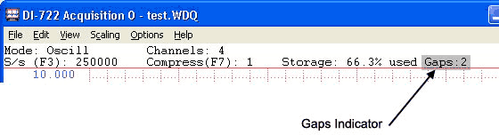

GAPS indication
The following illustrates the GAPS indicator.
The GAPS indicator is displayed (along with the number of gaps) at the right end of the status bar when data acquisition to disk has been non-continuous. A gap in the data file is the result of too much system activity (i.e., floppy disk operations, printing, running DOS programs, too many other applications running simultaneously, etc.) for the sample rate. Acquisition will restart automatically with the position of the restart marked in the file with a positive-going event marker. To avoid gaps, reduce the sample rate, increase the buffer size, or continue as described in the Streaming Data to Disk trouble shooting chart below.

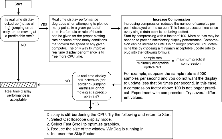

Real Time Display Considerations
An erratic jumping display, a display that does not move at a predictable rate, or one that does not scroll at all can be classified as unsatisfactory real time display performance. Unacceptable real time display performance occurs when an attempt is made to plot (or draw on the screen) too many points in a given period of time. The solution is to plot less often by increasing compression or increasing the skip factor. Refer to the Real Time Display trouble shooting chart below.
