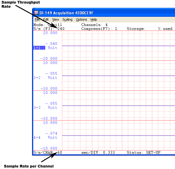

The sample rate shown in the top left corner of your display is a throughput
rate. The sample rate per channel (obtained by dividing the selected sample
throughput rate by the number of channels enabled) is
in the bottom annotation line as S/s/CHAN:.
Although there are thousands of different sample
rates that may be configured, some discrete rates are not achievable.
This limitation is due to the inability to divide the master clock in
a manner that results in a quotient that is an even number. For example,
this is the reason why you may get a sample rate of 2999.63 when you entered
3000.When using the DI-2108 you may enter a sample interval that automatically sets the burst rate high to minimize aliasing.
