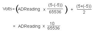

The most simplified formula would be as follows:
Generate/simplified1.jpg
so if your full scale range is +/-10Volts the formula would read:
Generate/simplified2.jpg
