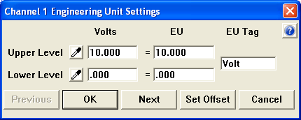

1.  Select Engineering Unit Settings:
  In the Edit menu click on Engineering Unit Settingsā€¦.
   Choose Edit Engineering Unit Settingsā€¦ (ALT, E, E or CTRL+F8)
When selected, the Engineering Unit Settings dialog box is displayed:

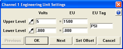

2.  When the relationship of volts to engineering units is known, define the relationship in the provided text boxes. For example, you know 5V equals 1500 PSI and 0V equals 0 PSI using your sensor. Enter the Volts and EU values in the appropriate text boxes:
