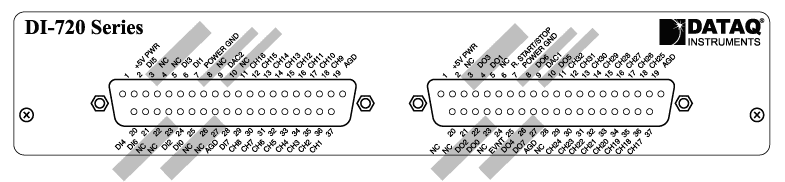

The default state of the digital output bits is “High.” Values and locations of the digital input bits are device dependent.
