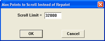

Specify the Scroll Limit.
 In the Preferences sub-menu click on Scroll Limit….
  Choose Edit Preferences Scroll Limit… (ALT, E, P, L).
This displays the Max Points to Scroll Instead of Repaint dialog box.
Enter in the text box the desired scroll limit in pixels. When the desired scroll limit is entered, Click the OK button or press the Enter key to close the dialog box.
