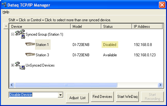

Disables the device without un-installing it. Your PC will not try to communicate with the device. This does not disable the device for all users - just you. This could greatly improve refresh rates when using the Find Devices button. It will also prevent you from using a device that another individual may have designated for an application.
  1. Select the desired device.
  2. Click on the drop down commands and select Disable Device.
  1. The status of the device will display "Disabled." You will not be able to perform any of the commands in the drop down command list except Remove Device and Enable Device.
  2. Select the device and click the Enable Device drop down command to access the device.
