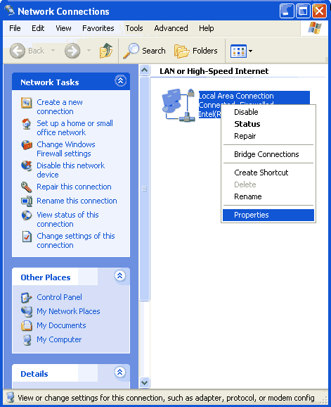

  1. Access Network Connections. How you access Network Connections is dependant on your Windows configuration. Possible options include but are not limited to:
  1. Click Start > Settings > Network Connections.
  2. Click Start > Control Panel. Click on Network Connections in the Control Panel.
  1. Right-click on the Network card your DATAQ Instruments devices are connected to and select Properties.

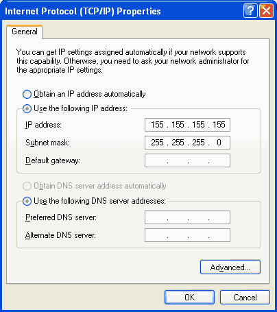

  1. In the Local Area Connection Properties window select Internet Protocol (TCP/IP) and click on the Properties button.
  1. In the Internet Protocol (TCP/IP) Properties window select Use the following IP address. Windows default is shown below. Note the settings for future reference.
  1. Enter an IP address in the space provided. Warning: Before connecting to your network through this network card you MUST revert to the old settings noted in Step 4 above.
  1. A Subnet mask should be entered automatically - if not, enter a subnet mask.
  2. Click OK to set your Network Card IP Address.
