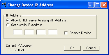

  1. Select the device you would like to change the IP address of.
  2. Select the Change IP Address drop down command.
  1. Select the Set a static IP Address option.
  2. Enter the IP address you would like to change the device to in the text boxes provided.
  3. If your device is a remote device (outside your sub-net), check the Remote Device checkbox. For more information about Remote Devices see Installing and Running a Device Outside your Sub Net.
  4. Click OK to set the IP address of the device.
