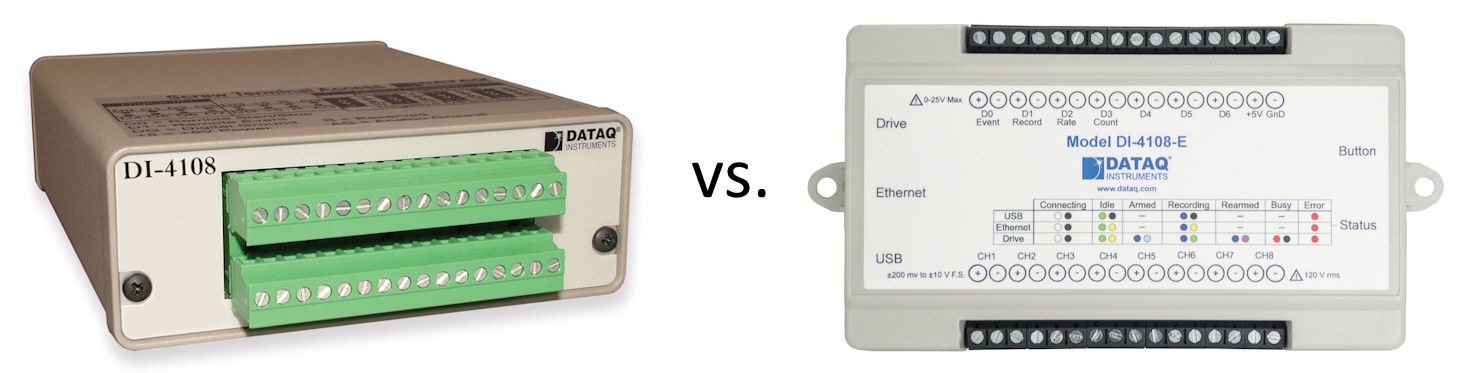

DI-4×08-E vs. DI-4×08-M: What’s the Difference?
At first glance, the DI-4×08-E and DI-4×08-M appear to be different data loggers all together. In reality, they’re built on the same physical platform. Besides the obvious difference (a metal enclosure vs. a plastic one), there are some important distinctions to be made.
The Enclosures
Ah yes, the enclosures. The DI-4108-E and DI-4208-E are housed in a hardened plastic enclosure, and measure 3.28D × 6.68W × 1.13H in. Two fixed-position screw terminal strips allow you to connect analog (bottom strip) and digital (top strip) signals. Bulkhead ears on either side of the DI-4108-E allow for mounting.
The DI-4108-M and DI-4208-M are housed in a rugged, steel wrap-around enclosure, measuring 5.5D × 4.25W × 1.5H in. Two removable screw terminal strips allow for signal connection, and easy signal/application swapping. Screw holes (4/40) on either side of the enclosure allow for mounting using optional right-angle brackets (part #100947-1).

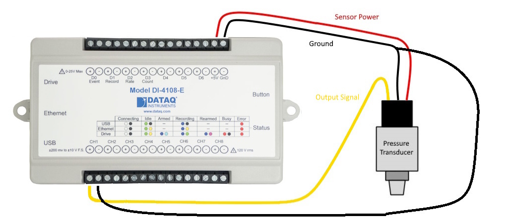

15VDC Power Supply
The DI-4108-M and DI-4208-M also feature built-in 15VDC power supplies. The 15VDC supply allows you to power sensor like our 4-20mA pressure transducers, which require an 8 to 30VDC supply voltage.
The 5VDC supply built into the DI-4108-E and DI-4208-E works for sensors with a lower supply requirement.
