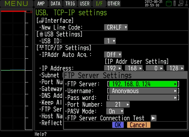

To do so, navigate to ‘FTP Server Settings’ in the ‘I/F’ tab on your GL820/900. Enter your PCs IP address, use ANONYMOUS as the username and leave the password blank (you can create your own username and password if you prefer). The default port number is 21.

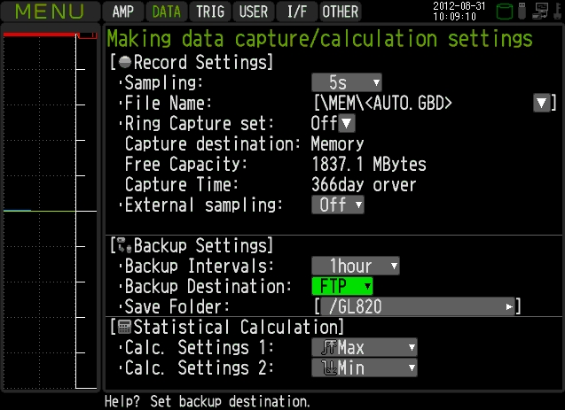

Once you’ve entered your FTP server settings, choose ‘FTP’ as your ‘Backup Destination’ in the ‘Data’ tab, select a backup interval (this tells the GL820/900 how often to back up data) and specify the virtual directory that will be your ‘Save Folder’ (Inetpub\ftproot  is the default).
With the Windows server set up as the backup destination, data files will appear in the specified folder on your local drive at the chosen interval.
