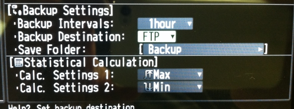

Set-up is simple. Begin by selecting FTP as the backup destination of the GL820 and choosing a backup interval.
820ftp1

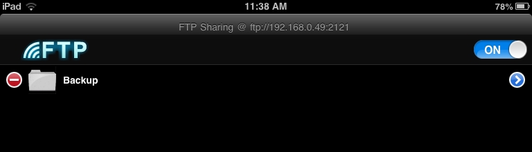

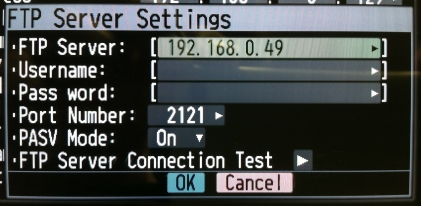

Next, navigate to the ‘I/F’ tab on your GL820 and enter the IP address (the devices IP) and port number provided by the mobile FTP app under ‘FTP Server Settings’.
FTP_iOSip
820ftp2

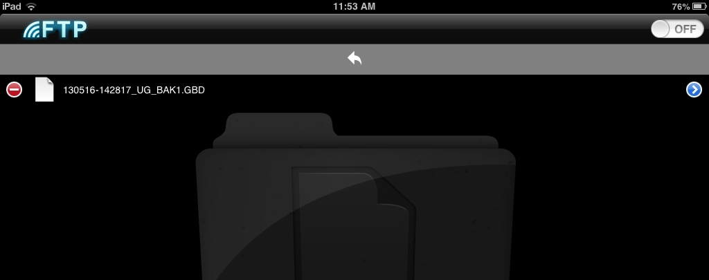

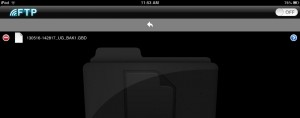

As the backup interval is reached, data will begin to populate the mobile server.
FTP_iOS
