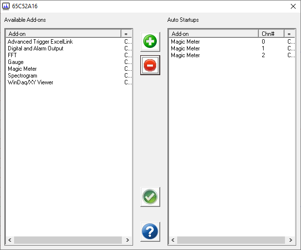

- 3. Navigate to WinDaq → View → Add-on... → Add-on Startup Config...
- 4.
Adds the selected add-on from the left panel to the auto startup operation.
- Once an addon is added, assign an index number so that its configuration will be saved, starting from 0.
- The index numbers should align with the WinDaq channel indexes.
- Example: If three analog channels are enabled in WinDaq and three MagicMeter were created, use index numbers 0 to 2, a total of 3, matching the total channel numbers.
- Once the configuration index is saved, the selected add-on will be launched for test drive, and you can setup accordingly
- 5.
Removes an unwanted add-on from the auto startup group on right panel. - 6.
Save the auto startup group when you are finished - 7. Restart WinDaq - all add-ons included in Auto Startup will now launch automatically. In the above example, three MagicMeters
