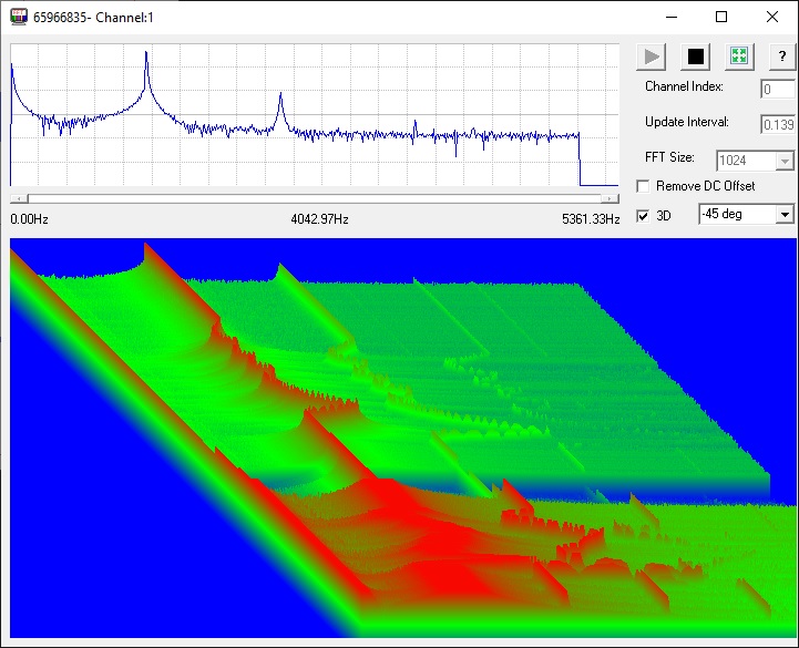

WinDaq Addon Spectrogram visualizes the frequency domain of an analog waveform in real-time, with 3D color-scaled waterfall spectrogram

- For the Spectrum display on top. While acquiring spectrum, you may
- click and hold the left mouse button to drag the waveform up and down
- double-click the left or right mouse button to change the scaling of the waveform.
- click and hold n the right mouse button to enable a vertical cursor to exam to the waveform.
- For the Spectrum display on top. Once you stop the live frequency display, you may
- click and hold the left mouse button on the chart to enable a vertical cursor and move it around to study the spectrum
- click and hold the right mouse button on the chart to enable a cross hair and drag it around to study the spectrum
- For the Waterfall display, you may
- click and hold the left mouse button on the waterfall chart to enable a crosshair to show the frequency/elapsed time
