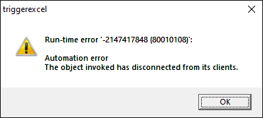

Microsoft Excel is not accessible, check if the active Excel book is closed accidentally

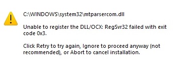

Failed to resister mtparsercom.dll, this problem is fixed, please download and install ExcelLink again

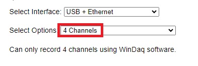

WinDaq Unlock key is needed to use more than 4 channels, for devices with only 4 channels unlocked, you will see this error message if you want to use more than 4 channels. Unlock the device to increase channel counts

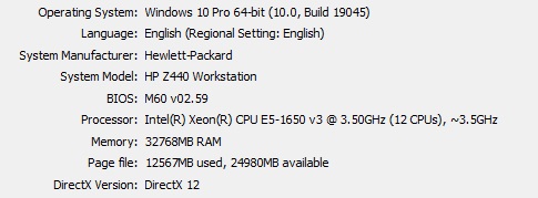

The work station with plenty memory works perfectly fine at 160K s/s WinDaq throughput rate
with Excel 365

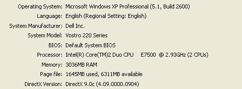

The old faithful XP with Excel 2000 works fine at 160K s/s WinDaq througthput rate, but it has other limitation arised from Excel 2000

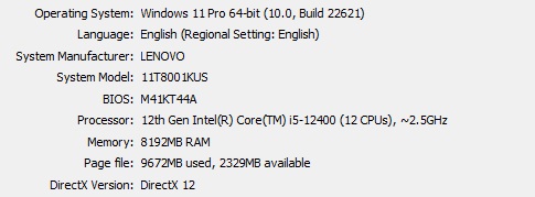

Powerful CPU but limited RAM, it can't reach its full potential
with Excel 365

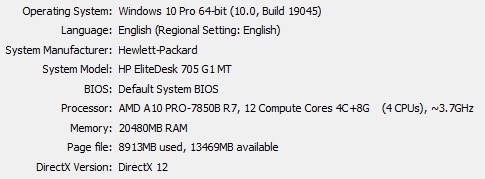

Even with plenty memory, this class of AMD
can't reach 80 K s/s with Excel 365, but it has no problem to reach 160K s/s at manual trigger mode ("multiple row" option) since there is no need to evaluate trigger experssion when WinDaq is minimized to reduce its load
