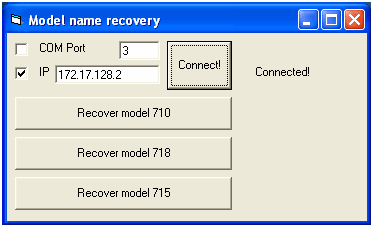

- For Ethernet Units:
- Click the "IP" checkbox and enter the IP address of your DI-71x-E. The IP address of your instrument can be found during installation or by running the DATAQ Instruments Hardware Manager (default location is in the Windows menu Start > Programs > WINDAQ > Dataq Instruments Hardware Manager).
Note: If you have multiple DATAQ devices connected to your PC or network, be sure you have the correct IP address for the instrument in question. Contact your system administrator for further help finding the IP address. - Click on the Connect! button.
- If the IP address is correct, the word "Connected!" will appear in the Model Name Recovery dialog box.
- Click on the "Recover Model" button that corresponds to your DI-71x-E (710, 718 or 715).
- Exit the Model Name Recovery program and cycle power on your DI-71x-E.

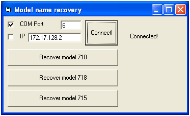

- For USB Units:
- Click the "COM Port" checkbox and enter the COM port number that your instrument is installed at. The COM port number can be found in the Windows Device Manager under “Ports (COM & LPT).”
- If the COM port number is correct, the word "Connected!" will appear in the Model Name Recovery dialog box.
- Click on the "Recover Model" button that corresponds to your DI-71x-U (710, 718 or 715).
- Exit the Model Name Recovery program and cycle power on your DI-71x-U.
- Run the WinDaq installation program and reinstall WinDaq software.
