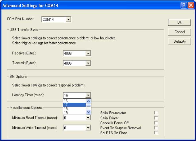

  6. Select the “Port Settings” tab and click the “Advanced” button.
    Select the Port Settings tab and click the Advanced button.
    click on image to enlarge
  7. In the “BM Options” box change the “Latency Timer (msec):” to 17 and click “OK.”
    In the BM Options box change the Latency Timer (msec): to 17 and click OK
