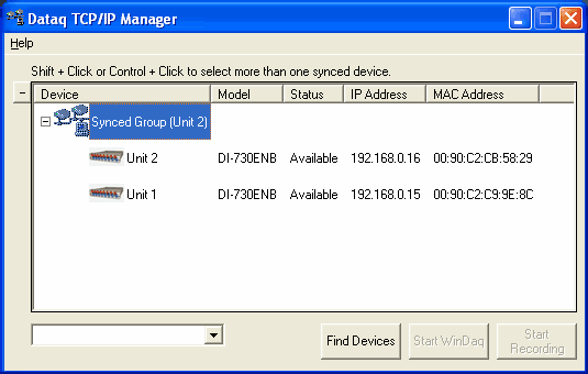

Upon completing WinDaq installation and running the IP Manager one or more DI-720/730 EN-B units is listed as "UnSynced" or is "Off Line."

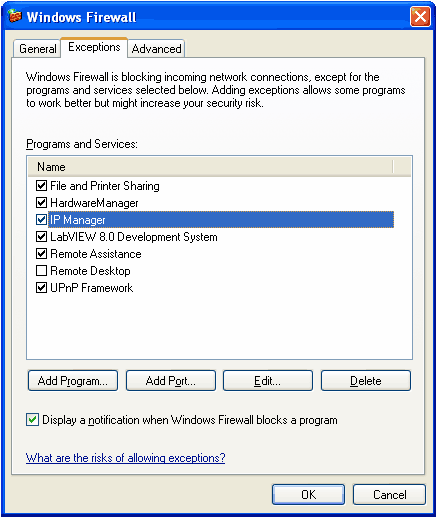

Verify Windows firewall settings
Make sure that your Windows firewall does not block the WinDaq IP Manager.
  1. Double-click on "Windows Firewall” in the Windows “Control Panel."
  2. Select the “Exceptions” tab and make sure that “IP Manager” is checked.

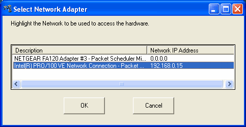

Verify that you have selected the correct Network Interface Card (NIC)
Upon running the IP Manager, be sure to select the network interface card that your DI-720/730 EN-B(s) is (are) connected to.

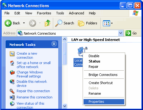

To enable the TCP/IP protocol:
  1. Select "Network Connections" from the Windows Control Panel.
  2. Right-click on “Local Area Connection” and select “Properties.”

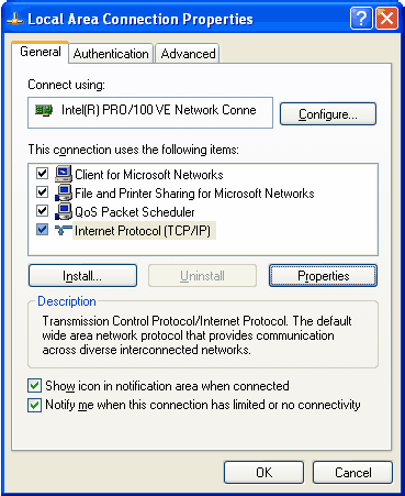

  3. Click on the “Internet Protocol (TCP/IP)” check-box.
Note: If "Internet Protocol (TCP/IP)" is not listed, click the "Install" button to initiate installation.

Make sure that the MAC/IP address listed in the IP manager matches the MAC address on the bottom of your DI-720/730 EN-B (or the IP address assigned to the unit).

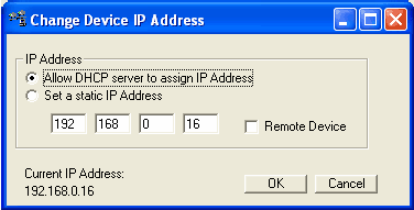

Verify that the unit is on the same subnet as your Network Interface Card
Check to make sure that your DI-720/730 EN-B has an IP address on the same subnet as your interface card.
Allowing the DHCP server to assign an IP address will ensure that your DI-720/730 EN-B has an appropriate IP address.
To let the DHCP server assign an IP address:
  1. Choose "Change IP Address" from the Dataq TCP/IP Manager
  2. Select the "Allow DHCP server to assign IP Address"
Change IP Address
When assigning a static IP address it is the customer's responsibility to make sure that the address is on the same subnet. Contact your system administrator for assistance.
