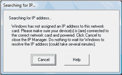

Upon running the IP Manager on a Windows Vista PC the following message is displayed but your network card is never assigned an IP address.
Searching for IP

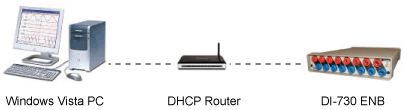

Connect your Ethernet instrument to a DHCP network/router or a Windows XP PC to assign a Static IP
The DHCP network/router (or Windows XP PC) will assign the DI-720, DI-730, or DI-785 a valid IP address. This will allow you to run the IP manager and manually assign the unit a generic static IP (an IP address assigned by the DHCP network/router (or Windows XP PC) will be lost when the unit is powered down while a manually assigned static IP address will be retained).
Network setup
Figure 1
Connect your DI-720/730/785 via a DHCP network/router
in order to assign the unit a static IP address.

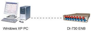

Direct connection
Figure 2
Windows XP uses IP v.4 exclusively allowing you to run the IP
Manager and assign your Ethernet instrument a static IP address.
Once your instrument has been assigned a static IP address it can be connected directly to a Windows Vista PC. The Vista PC will now recognize the IP v.4 address and maintain the default IP v.4 network configuration. As a result the network card will acquire an IP address and the IP Manager will run as intended.
