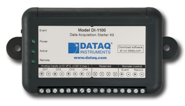

The problem described above affects any DI-1100 with a manufacture date between September 1, 2017 and October 30, 2017. The manufacture date of your DI-1100 appears on the sticker located on the bottom side of the instrument (see Figure 1.)
Figure 1
