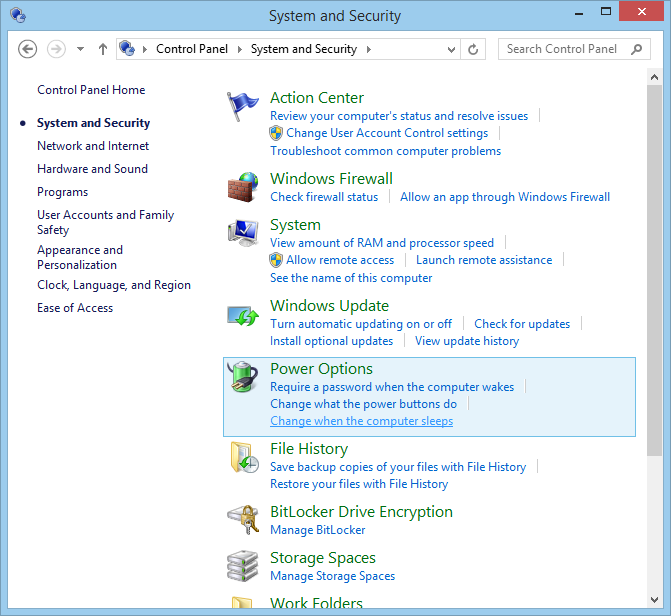

The key to resolve this problem is in Windows’ Power Options, which you can access via the Control Panel.

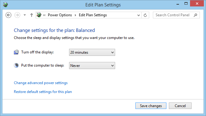

If you click Change when the computer sleeps you can adjust how long before sleep kicks in, anywhere from several minutes or hours to never. Frankly, if I’m contemplating any data acquisition activity at all on a PC, I leave my settings as shown in the following graphic to ensure that the computer never sleeps. One forgetful moment risks losing data that can never be retrieved. Note that the monitor winking out has no effect on the data acquisition process, so I allow the computer to control that with the knowledge that I’ve done my bit for a greener world without risking my precious data.

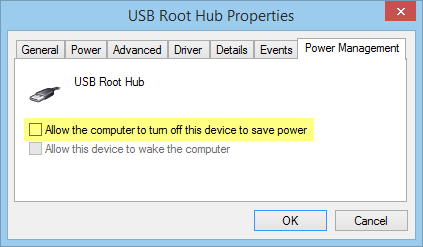

Even though you’ve adjusted power settings to stay out of trouble, you should also adjust the USB Root hub. Many have power management options that Allow the computer to turn off this device to save power. Accessible from Windows’ Device Manager, right-click USB Root Hub under the Universal Serial Bus Controllers tree, and select Properties. Make sure that option is unchecked. You may have to take this action for more than one root hub if the problem persists, since there isn’t a convenient method to determine which one hosts your data acquisition system.
