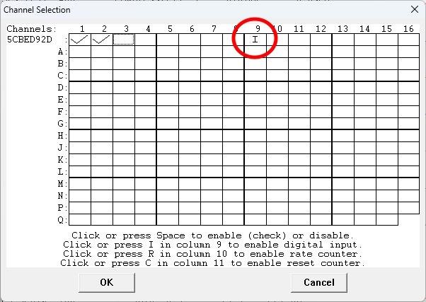

Enabling the Digital Channel
To insert event marks, you’ll first need to enable the digital channel in WinDaq.
To do so, choose ‘Enable Channels’ from the ‘Edit’ pull-down menu and click the channel 9 checkbox (as shown below).

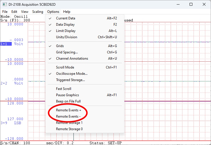

With the digital channel enabled, choose ‘Remote Event +’ or ‘Remote Event -‘ from the ‘Options’ pull-down menu.
Note that the digital ports (D0-D6 on most contemporary DATAQ data loggers) are all pulled high by default; so choosing ‘Remote Storage -‘ allows you to insert an event mark by simply shorting the “Event” terminal (D0).
With ‘Remote Events -‘ selected, and WinDaq recording, an event marker will be inserted in the file each time the ‘Event’ terminal (D0) is pulled low (shorted + to -).

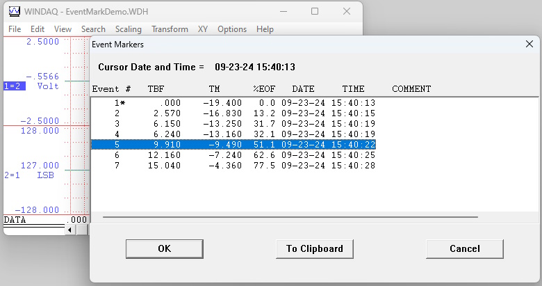

View Event Marks
Once data acquisition is complete, double click on a data file to open it in the WinDaq Waveform Browser.
To view your event marks, choose ‘Event Markers’ from the ‘View’ pull-down menu.

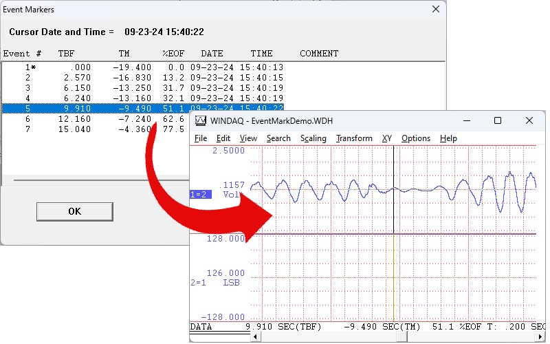

Double-click on an event marker to jump to that point in the data file (as shown below).
