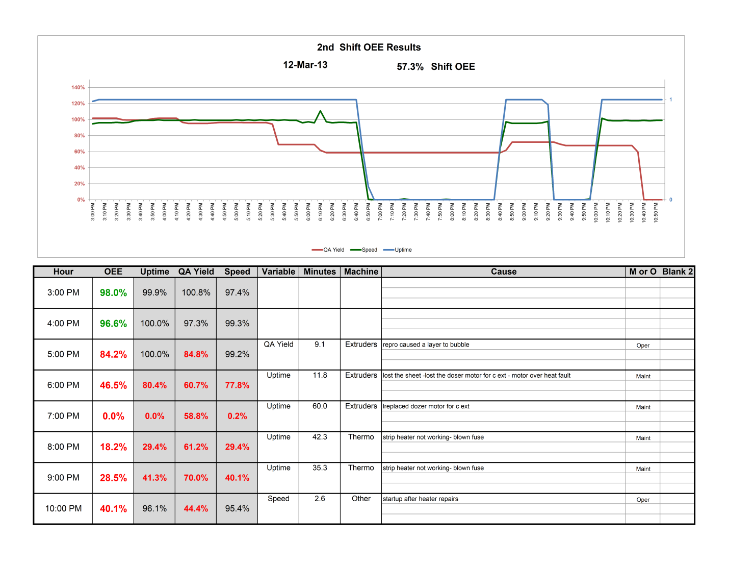

Figure 1 is a typical shift report generated by Microsoft® Excel using data logged by the DI-160. It equips the shift supervisor with a timeline graph for the entire shift, showing what OEE variable is responsible for performance loss. Since the shift supervisor has firsthand knowledge of what happened on the shift, he identifies and annotates directly into the report what machine on the line caused the problem, a description of the problem, and whether the problem was a maintenance or operations issue.
Figure 1
(click for a larger image)
Figure 1 is an example of a graphic representation of line productivity and typical shift supervisor notes that explain lost productivity.

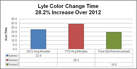

For example, our basic unit of measure for analysis and measuring improvement is minutes. Assume that a machine runs continuously for one hour without producing scrap.  That one hour represents 60 minutes of productivity. Now assume that we have a color change and during the color change we have to scrap the pots coming off the line until the new color meets spec.  Quality yield during the hour reduces to 50 percent due to the scrap.  We convert that 50% into minutes for our measurement.  One hour with 50% QA Yield is equivalent to 30 minutes of lost productivity.  If our standard is 20 minutes we try to discover the root cause for those lost 10 minutes of productivity. If we are trying to improve changeover time, we adjust the process and then monitor results (minutes per changeover) after the process adjustment to see if it reduces lost productivity measured, again, in minutes. Figure 2 is an example of how we graphically represent quality yield for our operations using data supplied by DATAQ Instruments’ DI-160 Event, State, and Count Data logger, and represents just one of several projects we are working on to improve performance of our thermoforming line.
Figure 2
(Click for a larger image)
Figure 2 shows the increase in average productive minutes after implementing changes that were suggested by measured up-time, down-time and yield data.
