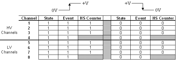

 Based on the documentation, the following chart illustrates the expected results on State, Event and High Speed Counter channels:
 As you can see, the state changes to ‘1’, an event is triggered, and a count is registered on a leading edge transition. No changes are registered on falling edge transitions.

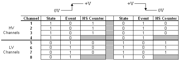

 The following chart illustrates the way DI-160s actually responded prior to 7/19/2012:
If you have a DI-160 that shipped prior to 7/19/2012, you can request a firmware upgrade (free of charge) by submitting a support ticket on the DATAQ website.
