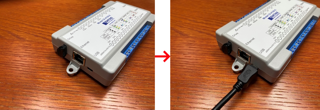

Next, insert an empty USB thumb drive, and power up the data logger.

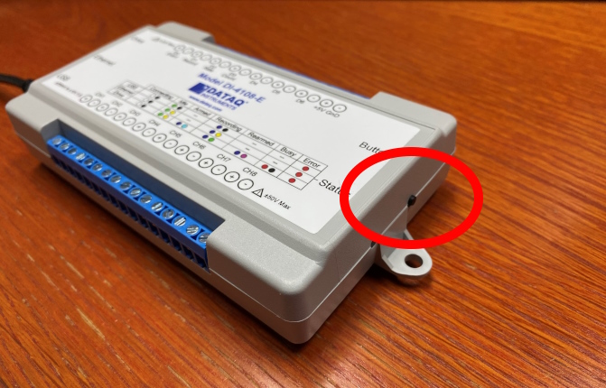

When the LED begins to blink white/black, press and hold the pushbutton.
Wait until the LED turns red before releasing the button.
Once the LED begins blinking Green/Yellow, remove the USB thumb drive.

  4. Insert the USB thumb drive from step 1 to the device
