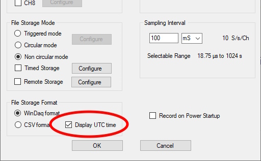

A new checkbox in Stand Alone Setup allows you to enable or disable the Universal (UTC) time option (as shown below).
How to Enable/Disable the UTC Time Option
You can leave the ‘Display UTC time’ option checked to include UTC date/time stamps (the default setting), or uncheck the option to display date/time stamps in local time. Note that this is for date/time stamps included in CSV format, only. WinDaq (WDH) files will always use UTC time internally.
