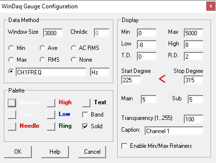

- Hover the mouse pointer to the upper left area of Gauge to reveal the configuration button
- Click the configuration button to adjust the settings
- Data Window to perform the following operations
- None: The most recent reading of the selected/highlighted channel when MagicMeter is started
- Average: Average all readings of the selected/highlighted channel when MagicMeter is started in the data window before presenting it
- Minimum: Display only the minimum reading of the selected/highlighted channel when MagicMeter is started within the data window
- Maximum: Display only the maximum reading of the selected/highlighted channel when MagicMeter is startedwithin the data window
- RMS: Perform RMS for all readings within the data window of the selected/highlighted channel when MagicMeter is started
- AC RMS: Average all readings of the selected/highlighted channel when MagicMeter is started and use the result as offset. Remove the offset of all readings then perform RMS
- Calculated Channel: please click here to learn how to configurate the math expression. In this option, readings from any enabled channel can be used
- Select font color based on high/low limit
- Specifiy transparency level

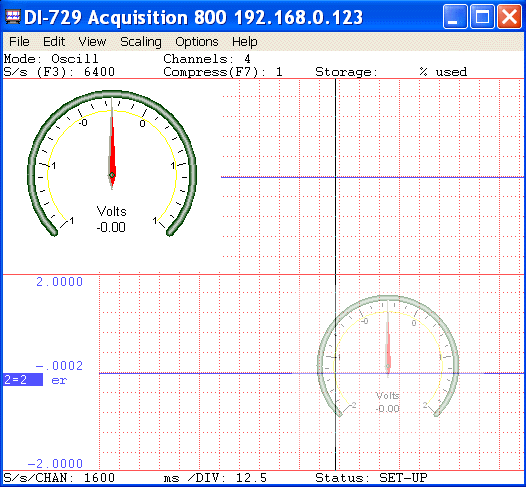

- Double click on face of Gauge display to switch to transparent mode
- Although the Gauge appears to embed inside WinDaq, it is NOT. When you move WinDaq's window around or add/subtract channels, it will NOT follow your action
