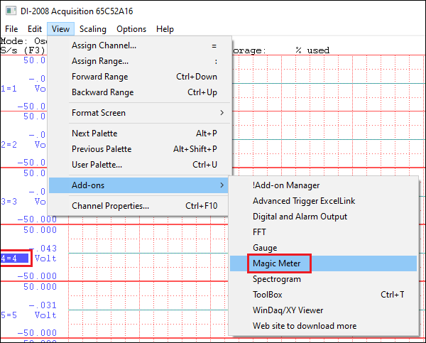

To Start WinDaq UtilityPack Addons
To invoke any WinDaq UtilityPack addon, start WinDaq, confire it properly first, highlight or select a channel you wish to apply the addon, in the following screen, channel 4 is selected, then follow WinDaq->View->Add-ons-> to invoke the addon, in the following screen, Magic Meter is started on Channel 4 by default. WinDaq configuration should not be modified once WinDaq addon starts to stream data. Pause the addon before changing WinDaq configuration, or some addon may terminate.
