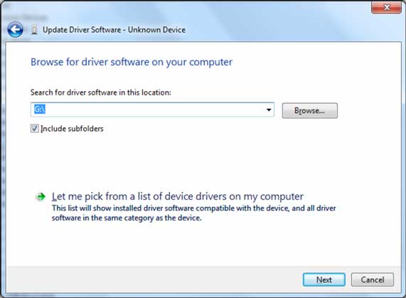

  4. Choose “Browse my Computer for driver software.” Navigate to the location of the driver and click “Next.”

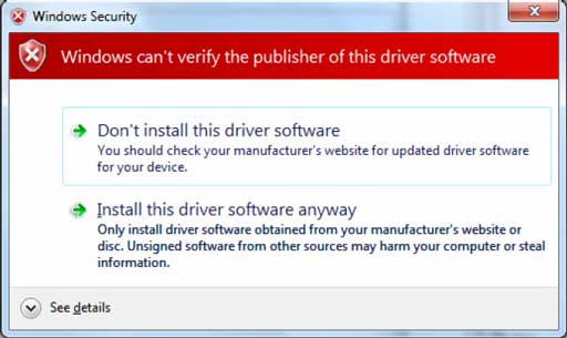

  5. When notified that “Windows can't verify the publisher of this driver software,” choose “Install this driver software anyway.”
