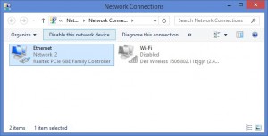

5.)    Select the Local Area Connection (the network interface controller NIC that the DI-7×0 is connected to) and click ‘Disable this network device’.

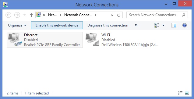

6.)    Once disabled, click ‘Enable this network device’ to re-enable the network card.
Enable
With the NIC disabled and re-enabled, you can run the DATAQ IP Manager normally, select you DI-720/730 and choose ‘Start WinDaq’.
