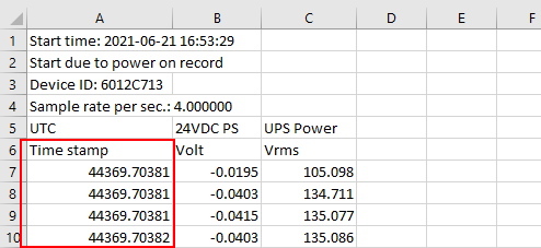

When recording CSV data in stand-alone mode using a contemporary DATAQ data logger in, the date/time stamp might look a little peculiar. That’s because dates and times are stored as floating real numbers, and look something like this:
44369.7038194444
The time portion of the date/time stamp is represented as a decimal fraction, where 24 hours = 1 full day, an hour is 1/24 of a day (0.04167), a minute is 1/1,440 of a day (0.000694) and a second is 1/86,400 of a day (0.00001157).
So 44369.7038194444 equates to 6/22/21 (44,369 days from 01/01/1900) and .7038194444 equates to 4:53PM (24 x 0.703819444 or 16:53:00).

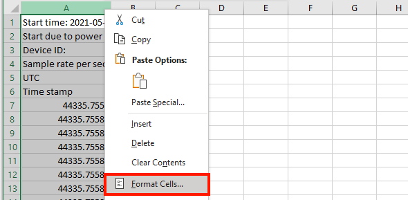

Simply right-click on the date/time column (column A) and choose ‘Format Cells’ (as shown below).

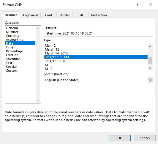

Here you can choose the ‘Date’ or ‘Time’ category and select a format type that’s more to your liking.

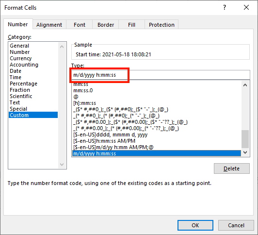

Choosing the ‘Custom’ category allows for even greater customization, as shown below.

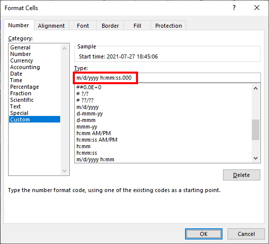

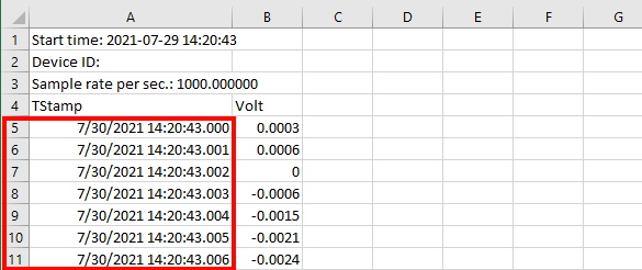

With the ‘Custom’ category chosen, and because of the precision allowed using floating real numbers, you can display time to the thousandth of a second*.
Simply add .000 to the end of custom format type, as shown below.
The floating real number format, generated when recording CSV data in stand-alone mode, allows for high accuracy date/time stamp information. And while the format may not be easy to look at or to interpret at first glance, tools in Microsoft Excel make it easy to turn this information into a meaningful and precise date/time stamps.
