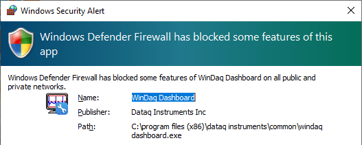

Upon launching and installing the application, if you see the following Windows Security Alert…
you’ll need to make the WinDaq Dashboard an exception in Windows Defender Firewall setting.

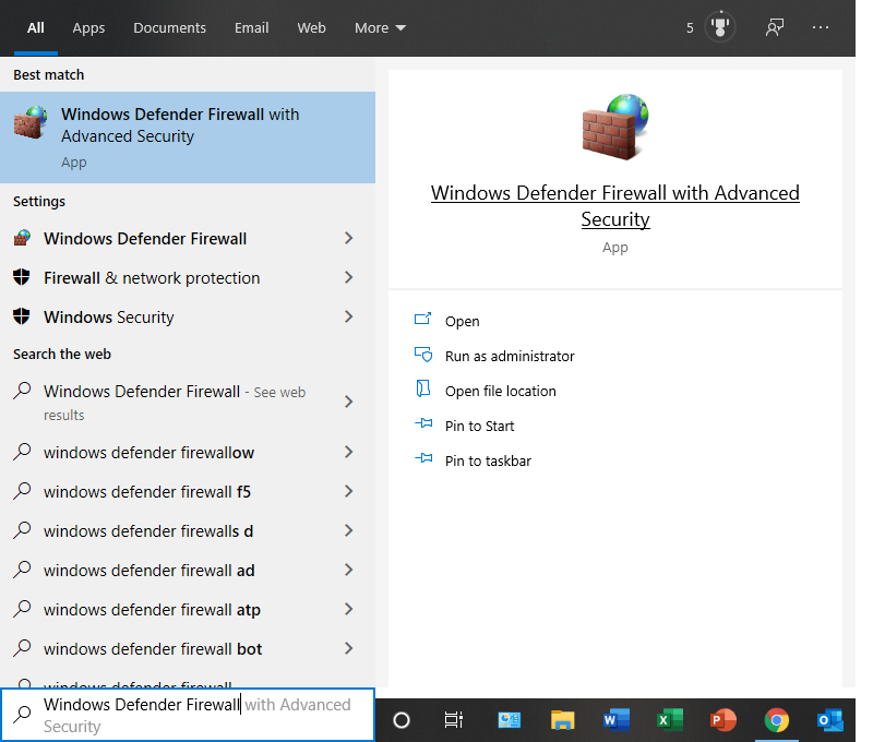

1.) In the lower left-hand corner of the Windows desktop, click ‘Start a search’ and type Windows Defender Firewall.

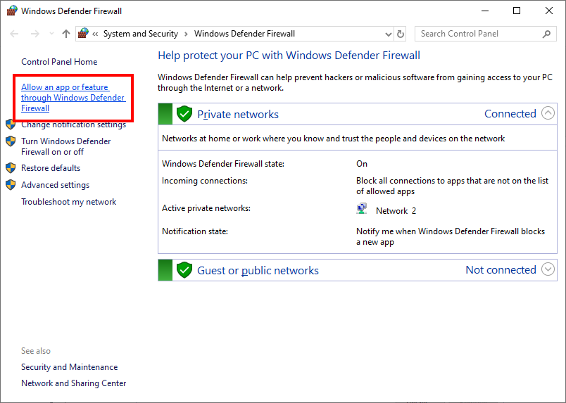

2.) From the ‘Windows Defender Firewall’ window, click ‘Allow an app or feature through Windows Defender Firewall’.

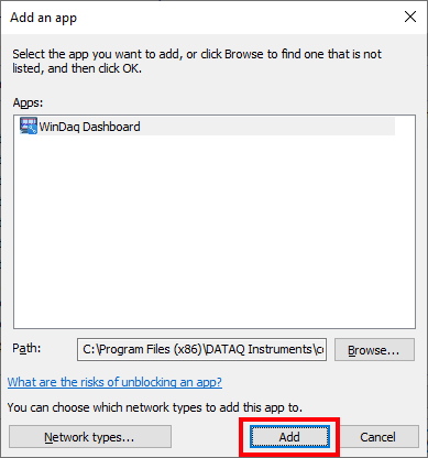

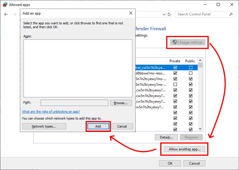

3.) In the ‘Allowed Apps’ window, click the ‘Change Settings’ button, choose ‘Allow another app…’ and click ‘Add’ in the ‘Add an app’ window.

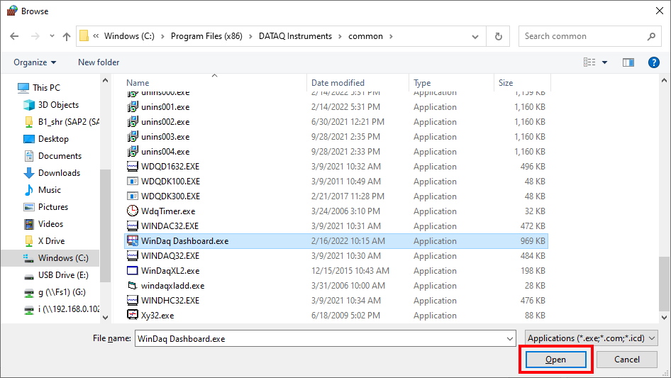

4.) Navigate to the DI316ANT.EXE application (located in C:\Program Files (x86)\DATAQ Instruments\common by default), and click ‘Open’.

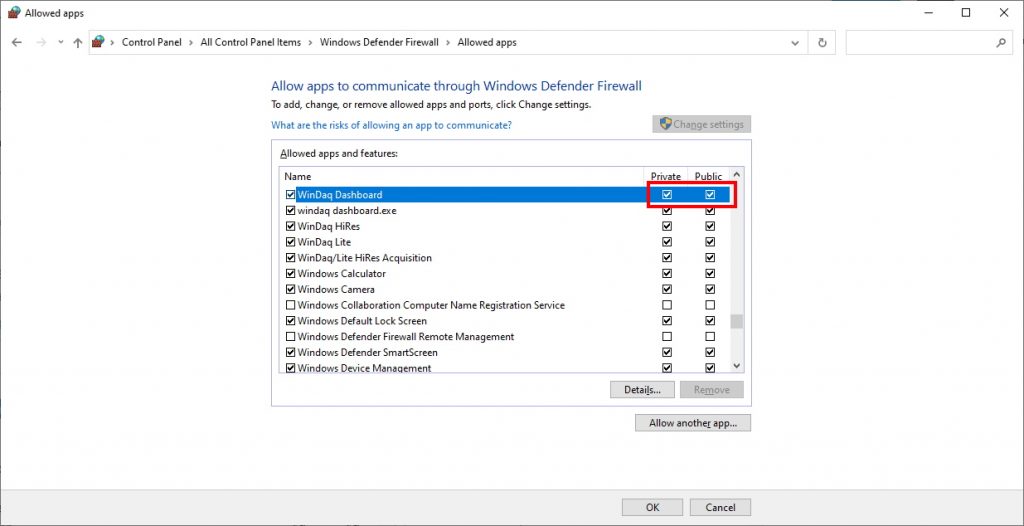

5.) Finally, click the ‘Add’ button to allow WinDaq/Lite HiRes Acquisition (DI316ANT.EXE) through the Windows Defender Firewall.
Be sure and click both the Private and Public checkboxes.
