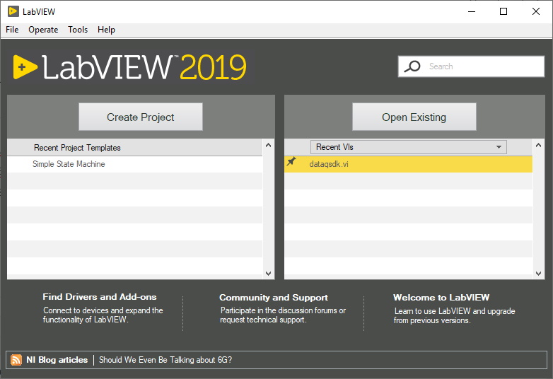

5.) From the LabView project menu, run dataqsdk.vi.

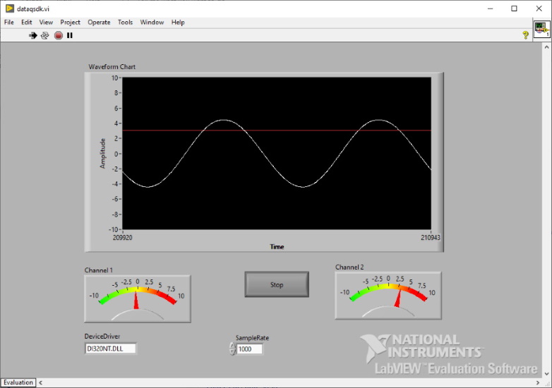

6.) From the Front Panel, click the ‘Run’ button.
7. With the vi running, enter a sample rate and click the ‘Start’ button.
8. That’s all there is to it! You should see real-time data in the LabView chart.
