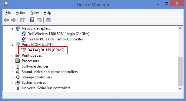

Ensure that your DI-145, 149 or DI-155 is listed in the Windows Device Manager under ‘Ports (COM & LPT)’.
To do so:
  1. If it isn’t already, connect the DI-145, DI-149 or DI-155 device to your PC.

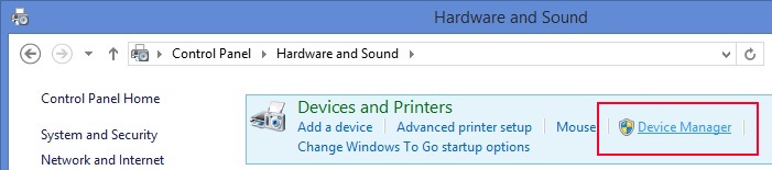

  2. In the Windows Control Panel select ‘Hardware and Sound’ and choose ‘Device Manager’ from the ‘Devices and Printers’ group.
  3. Your DI-145, DI-149 or DI-155 USB device should be listed in the Windows Device Manager under ‘Ports (COM & LPT)’.

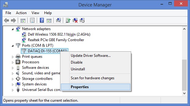

  4. Assuming that the device is installed on an unsupported COM portRight-click on the ‘DATAQ DI-1xx (COMxx)’ and choose ‘Properties’:
  5. Right-click on the ‘DATAQ DI-1xx (COMxx)’ and choose ‘Properties’

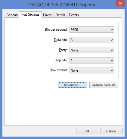

2. Click the ‘Port Settings’ tab and click the ‘Advanced’ button

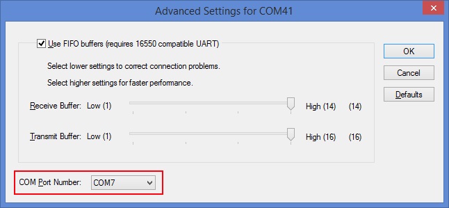

3. Click the ‘COM Port Number’ pull-down menu and choose a COM port between 3 and 32.
