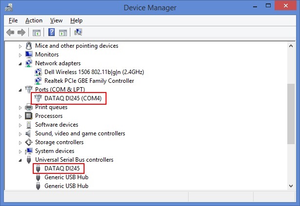

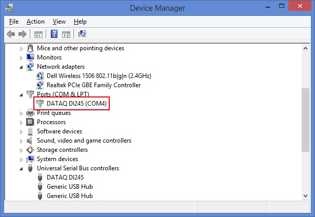

Ensure that your DI-245 is listed in the Windows Device Manager under ‘Ports (COM & LPT)’ and ‘Universal Serial Bus controllers’.
To do so:
- If it isn’t already, connect the DI-245 to your PC.

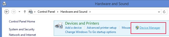

- In the Windows Control Panel select ‘Hardware and Sound’ and choose ‘Device Manager’ from the ‘Devices and Printers’ group.
- Your DI-245 USB device should be listed in the Windows Device Manager under ‘Ports (COM & LPT)’ and ‘Universal Serial Bus controllers’.
- If your DI-245 is listed in the Windows Device Manager under ‘Ports (COM & LPT)’ or ‘Universal Serial Bus controllers’, but not both, right-click on the DATAQ DI-245 under ‘Ports.

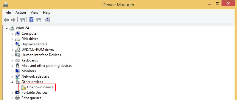

The DI-245 may also appear as ‘Other Devices’ or an ‘Unsupported Device’. If so:
- Right-click on the ‘Unknown device’ and choose ‘Uninstall’.
- Unplug your DI-145, DI-149 or DI-155, and plug it back in again.
- Wait a minute or two for Windows to locate and install the device driver.
Does the DI-245 now appear under both ‘Ports (COM & LPT)’ and ‘Universal Serial Bus controllers’? If not proceed to the next step.

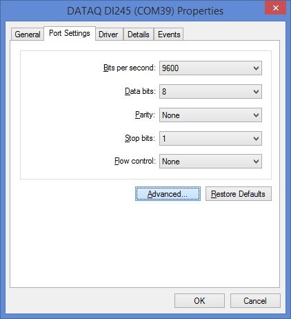

Make sure that your DI-245 is installed on one of the first 32 COM ports
DLLs are installed for the first 32 COM ports only.

- Your DI-245 should be listed in the Windows Device Manager under ‘Ports (COM & LPT)’ on one of the first 32 COM ports.

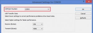

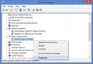

- Assuming that the device is installed on an unsupported COM port:
- Right-click on ‘DATAQ DI245 (COMxx)’ and choose ‘Properties’
- Click the ‘Port Settings’ tab and click the ‘Advanced’ button
- Click the ‘COM Port Number’ pull-down menu and choose a COM port between 3 and 32.
Run the DATAQ Instruments Hardware Manager. Does the DI-245 show up with a Status of ‘Available’? If so, run WinDaq. If not proceed to the next step.

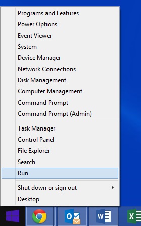

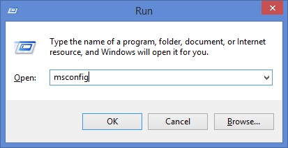

- Right-click on the Windows button (click the Start button on a Windows 7 machine) and choose ‘Run’.
- Type MSCONFIG in the run window and click the “OK” button.
- From the ‘System Configuration Utility’, select the ‘Startup’ tab.
- Disable any questionable items (you can re-enable them later).

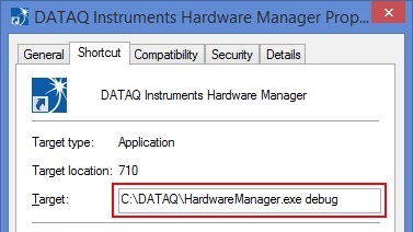

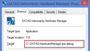

- Right-click on the shortcut that you use to run the DATAQ Instruments Hardware Manager and select ‘Properties’.
- Add the word debug to the end of the “Target:” line.
- Run the DATAQ Instruments Hardware Manager. This will generate a debug710.log file.
