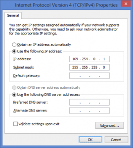

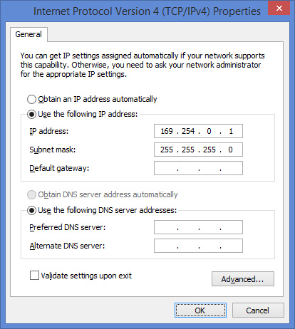

Verify that your Network Interface Card (NIC) has a static IP address
As outlined in the Installation Guide, verify that your NIC (TCP/IPv4) has a static IP address.

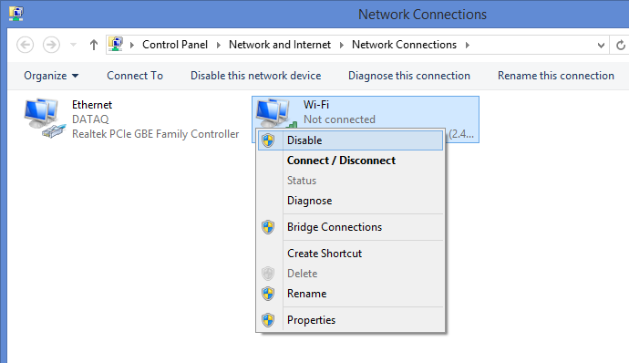

Disable any wireless connections

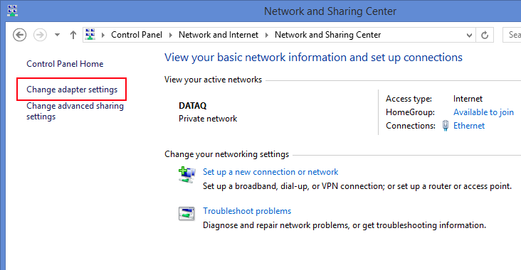

Make sure that any wireless connection are disabled (not just disconnected).
To do so, open the Windows Control Panel, choose ‘Network and Internet’ and select ‘Change Adaptor Settings’.
Ethernet Connected
Right-click on the Wi-Fi connection and choose ‘Disable’

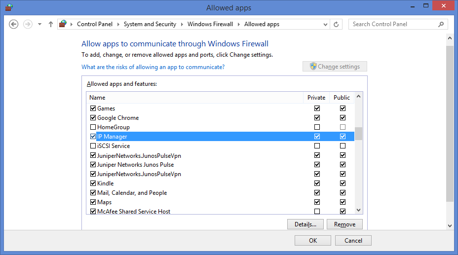

Verify Windows Firewall settings
Make sure that the DATAQ IP Manager is allowed through the Windows firewall, for both Private and Public networks.
Ethernet Connected
To do so, open the Windows Control Panel, choose ‘System and Security’ and select ‘Allow an app through Windows Firewall’.
Select both the ‘Private’ and ‘Public’ checkboxes.

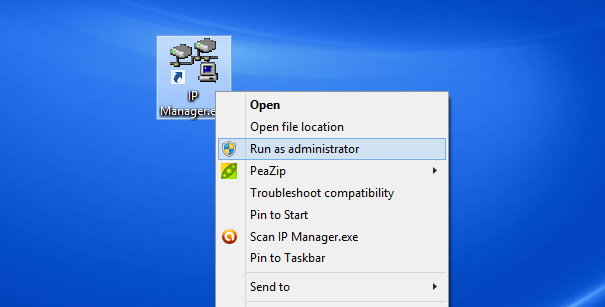

Run the DATAQ IP Manager as an administrator
Right-click on the ‘IP Manager’ shortcut and choose ‘Run as administrator’

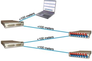

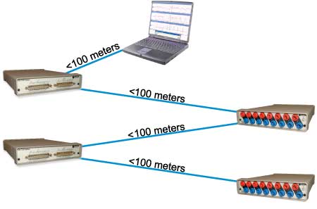

Make sure that your Ethernet cables are not more than 100 meters in length
The Ethernet cable connecting your DI-720/730 EN-B to the PC and ones between synced units cannot exceed 100 meters in length.

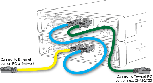

Verify that your Ethernet cables are connected correctly
The “Toward PC” connection on the back of the first synced (unsynced) DI-720/730 EN-B should be connected to the Ethernet port of the PC or network. The “Toward PC” connection of the second synced unit should be connected to the “Expansion” connection of the first synced unit, the “Toward PC” connection on the third synced unit to the “Expansion” connection on the second synced unit, etc.

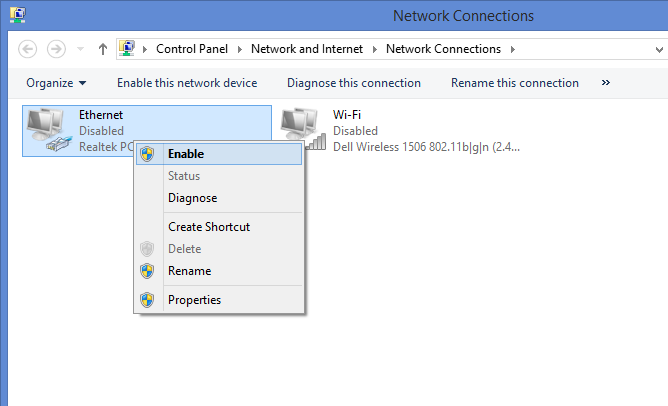

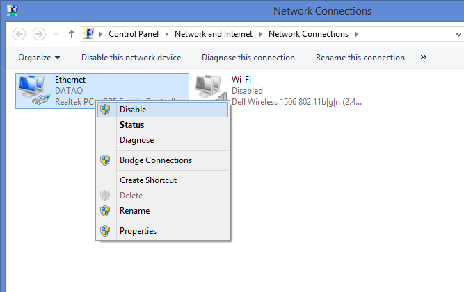

Reset your Network Interface Card (NIC)
To reset your Network Interface Card, open the Windows Control Panel, choose ‘Network and Internet’ and select ‘Change Adaptor Settings’.
Ethernet Connected
Right-click on the network connection and choose ‘Disable’

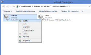

Ethernet Connected
With the connection disabled, right-click again and choose ‘Enable’
