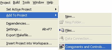

STEP 1: Click Project>>Add To Project>>Components and Controls:

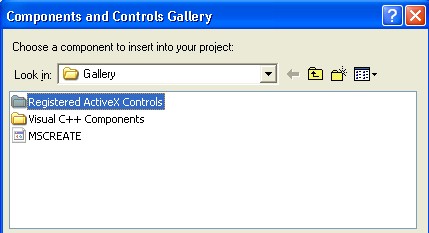

STEP 2: In the Components and Controls Gallery, open the Registered ActiveX Controls folder:

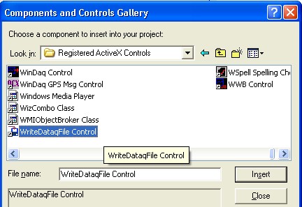

STEP 3: Click on the DATAQ ActiveX Controls that you want to add to your project and then click Insert. The DATAQ ActiveX Controls include: DataqSdk, DQChart, ReadDataqFile, WinDaq, WriteDataqFile, WWB:
The selected ActiveX Controls will now appear in your toolbox:
