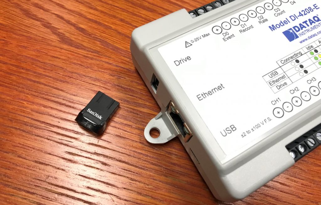

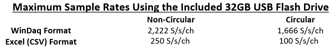

The 32GB USB flash drive included with all contemporary DI-2000 and DI-4000 series data loggers allow for stand-alone sample rates in excess of 1,000 samples per second, per channel
The included 32GB USB flash drive.

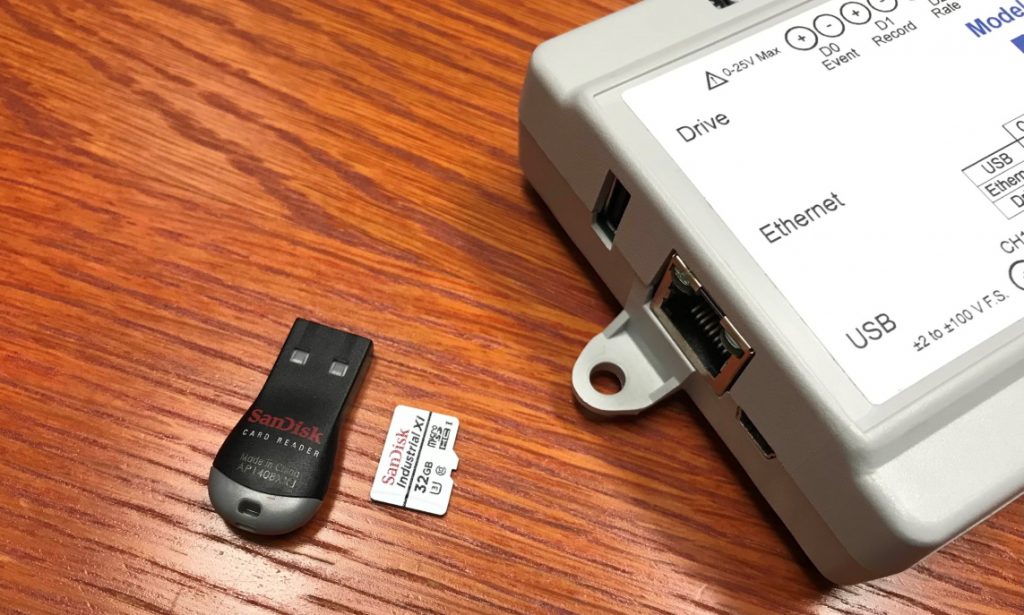

Optional SLC high speed cards allow you to sample at throughput rates higher than 80 kHz.
Industrial grade microSD card with USB A adapter.
