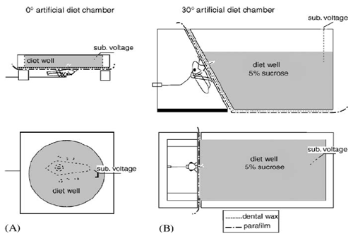

In order to produce EPG waveforms researchers use a silver conducting paint to "glue" a 50µm diameter, 1.5cm gold wire to a Sharpshooter's body. When the sharpshooter inserts its stylet (mouthpart used to penetrate plants) into an electrified substrate, a current path is created. To accomplish this task, the Sharpshooter is placed into a diet chamber.
The diet chamber (Figure 2) consists of a Plexiglas enclosure divided in two by a Parafilm partition (acting as artificial plant medium). The Glassy-winged Sharpshooter is positioned on one side of the partition and a sugar-water solution is added to the other. The gold wire, "glued" to the Sharpshooter, is connected through an EPG amplifier to the DI-720. A wire conveying a substrate voltage of between 50 and 80mV is then placed into the sugar-water solution.
Figure 2
Diagram of artificial diet chambers. (A) Side and stereoscope view of a zero degree chamber. (B) Side and stereoscope view of a 30 degree diet chamber.

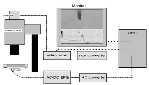

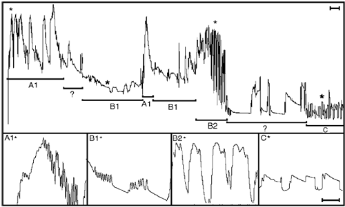

As the Sharpshooter's stylet pierces the Parafilm partition and the insect begins the process of feeding, unique waveforms are generated as a result of fluctuations in resistance (R = V / I). At the same time a CCD camera records images the process through a stereomicroscope (Figure 3). This allows researchers to associate unique EPG waveforms with each step of the feeding process (Figure 4).
Figure 3
Equipment configuration for split screen video of stylet activities and EPG waveforms.
Figure 4
(A1) Stylet probing begins. (B1) Secretion of saliva is observed (B2) The maxillary stylets are rapidly extended and retracted. (C) Fluid uptake (suction) was observed.
