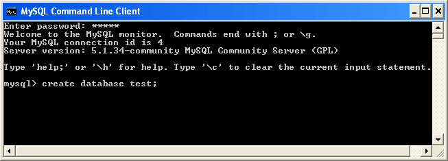

With the connector/ODBC driver installed, we can run the MySQL Command Line Client (if you don’t have MySQL you can download it for free at www.mysql.com) and create a database.
For this example we'll create a database called “test.”
MySQL command line create database

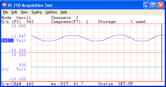

First we'll need to run WinDaq.
WinDaq Data Acquisition

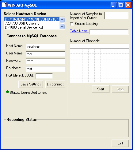

Next we'll run the WinDaq/MySQL application, select the appropriate data acquisition device (a DI-710-ULS in this case) and enter our log-in information. We'll specify the database into which data will be stored (test) and click “Connect.”
WinDaq/MySQL Window

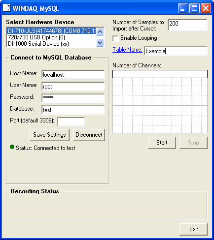

With WinDaq/MySQL connected to the “test” database we'll enter the number of samples to collect, choose whether or not to loop (continuously update) the data and name the table. The table is the collection of rows and columns used to organize our data.
WinDaq/MySQL window

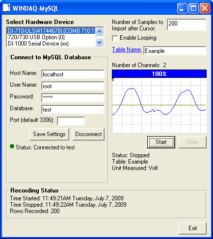

Finally, we'll click the “Start” button and watch as data streams into the “test” database.
WinDaq/MySQL window streaming data

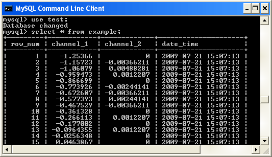

Stored data can be viewed in the MySQL Command Line Client.
MySQL Command Line client showing data
